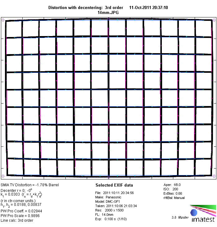

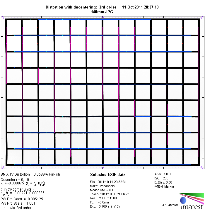

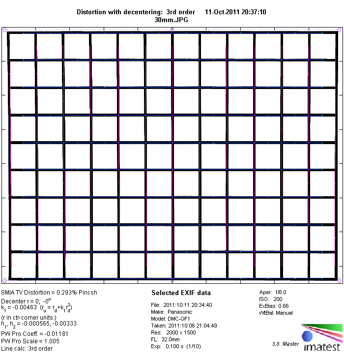

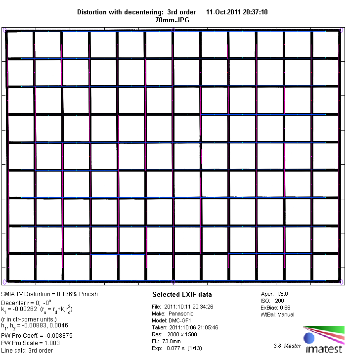

The image distortion produced by micro four-thirds images is auto-corrected either directly in the camera (JPEGs) or in most RAW-converters. The "exposed" distortion is therefore very moderate especially for an ultrazoom. It ranges from a moderate (~1.78%) barrel distortion at 14mm to marginal (0,06%) pincushion distortion at 140mm. This is nothing to worry about from a field perspective.
However, the non-corrected raw images show a pretty different situation with an extreme (~6.16%) barrel distortion at 14mm as well as slight (0.52%) barrel distortion at 140mm.
If you move your mouse cursor over the image you can switch to the corresponding non-corrected results.
