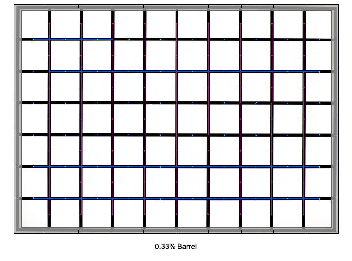

No surprises here: the lens shows almost no distortion, but anything else would have been a major disappointment for a macro prime.

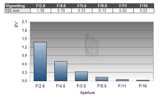

The light fall-off towards the image borders is a little pronounced at the largest aperture setting, reaching a value of almost 1.4 stops here. As usual, stopping down resolves the issue. From f/5.6 onwards vignetting should no longer be a visible issue for most subjects.
We're performing our vignetting analysis based on (uncorrected) JPEGs straight from the camera. The JPG engine of the Nikon D3x features a rather flat gradation curve, thus has a moderate contrast characteristic, resulting in comparatively low vignetting figures - the corresponding Canon figures are roughly 40% higher due to the more aggressive default contrast setting.

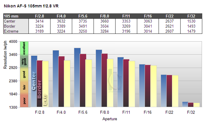

The lens delivers very good resolution in the image center at the maximum aperture, increasing to excellent values stopped down to medium apertures.
Borders and corners follow a bit behind with very good resolution throughout most of the tested aperture range. Stopped down to medium aperture settings, the borders even manage to reach excellent sharpness, too.
From f/11 onwards, diffraction starts to take its toll and reduces the achievable resolution. The lens can be stopped down to f/32, but at this setting not much resolution is left. This is a physical limitation and not a design flaw of the lens.
It's worth to mention that the lens showed no focus shift when stopping down.

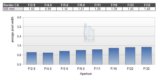

Chromatic aberrations (color shadows at harsh contrast transitions) range from 1 to almost 1.5 pixels on the image borders, slowly increasing by stopping down.

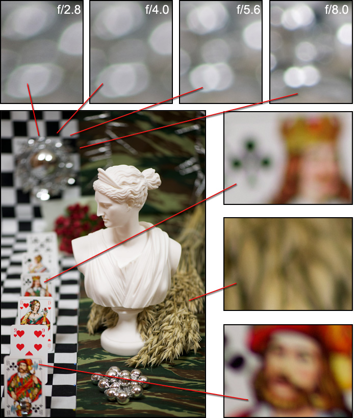

Bokeh Fringing
Bokeh fringing is a common issue with relatively fast glass. It's visible as halos of different colors in out-of-focus areas - magenta (red + blue) in front of the focus point and green beyond.
Typical for most primes in this class, the Nikkor shows a noticeable amount of bokeh fringing at large aperture settings, which can of course be reduced by stopping down.
As mentioned earlier, these shots also illustrate that there is no focus shift by stopping down.
Move the mouse cursor over the f-stop marks below to observe the respective bokeh fringing
f/2.8 f/4.0 f/5.6 f/8.0 f/11.0
