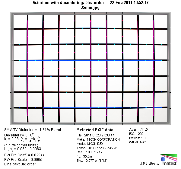

The Zeiss Distagon 35mm f/2 produces a moderate degree (~1.8%) of barrel distortion.

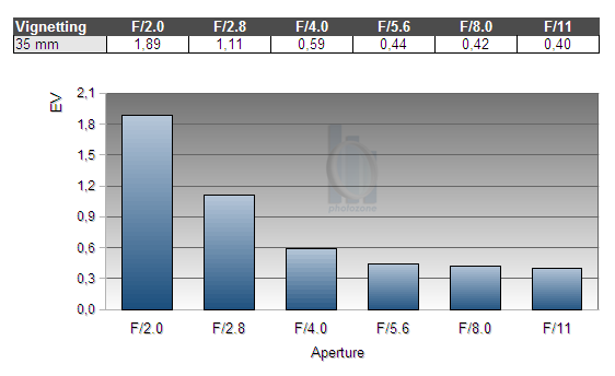

The vignetting characteristic seems to be a real weakness of Zeiss Z-series lenses when used on full format DSLRs. The Distagon shows a fairly extreme deterioration of ~1.9EV at f/2 - this will be visible in most scenes. The problem is still very pronounced at f/2.8 (@ ~1.1EV) but it's not overly significant anymore from f/4 onwards.
We're performing our vignetting analysis based on (uncorrected) JPEGs straight from the camera. The JPG engine of the Nikon D3x features a rather flat gradation curve, thus has a moderate contrast characteristic, resulting in comparatively low vignetting figures - the corresponding Canon figures are roughly 40% higher due to the more aggressive default contrast setting.

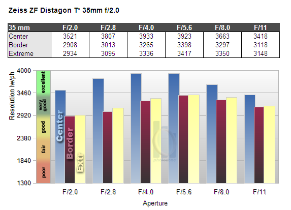

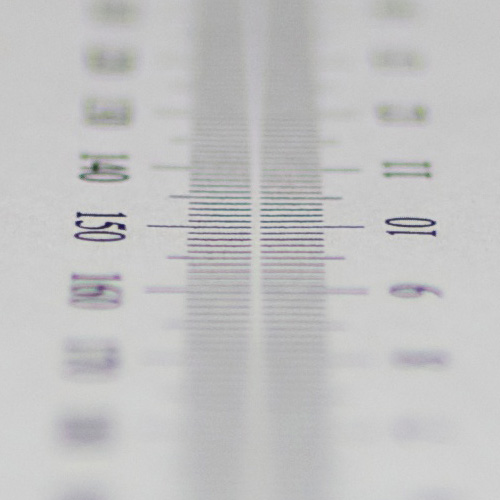

The Zeiss was able to deliver convincing results during our resolution tests. The center performance is great straight from f/2 onwards. The borders/corners follow on a good to very good level here. The peak performance is reached between f/4 and f/5.6 - the quality is very high across the frame here. Diffraction effects are starting to have an impact from f/8 onwards. However, the quality is still easily usable at f/11.

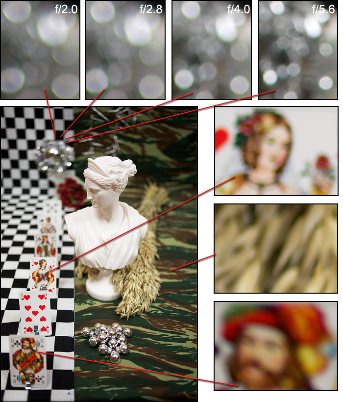

One of the main features of large aperture lenses is to seperate the main subject from the background. In such an image the quality of the bokeh (out-of-focus blur) is of major significance.
The bokeh in the transition zone shows traces of nervousness, but actually it's very smooth for a lens in this class.
Background highlights retain a circular shape throughout most of the aperture range, except towards the image corners. Due to vignetting they are cut off on one side at f/2. There is a visible amount of outlining as well as some traces of bokeh fringing (which is typical for this lens class, see next section). Bokeh fringing can be reduced by stopping down, however the outlining remains.
