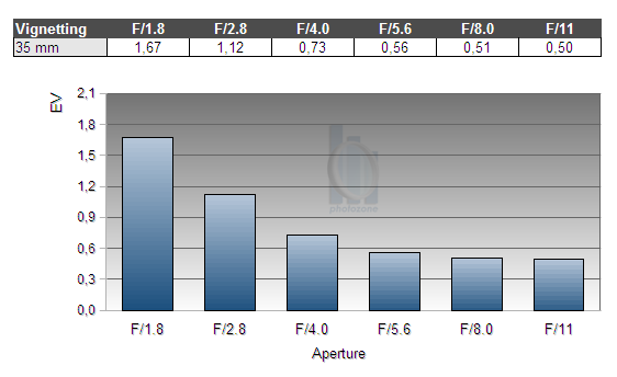

Very fast lenses usually suffer from pronounced vignetting at large apertures, and the Tamron lens is no exception to this rule. Wide open, there is a very visible amount of light fall-off (~1.7 EV) towards the corners. As usual, stopping down reduces the amount of vignetting considerably. From f/4 onward it should no longer be an issue for most scenes.
We're performing our vignetting analysis based on (uncorrected) JPEGs straight from the camera. The JPG engine of the Nikon D3x features a rather flat gradation curve, thus has a moderate contrast characteristic, resulting in comparatively low vignetting figures - the corresponding Canon figures are roughly 40% higher due to the more aggressive default contrast setting.

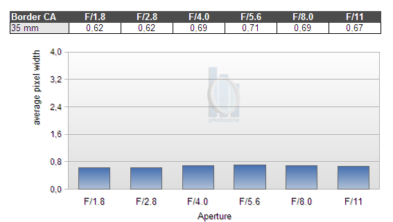

Chromatic aberrations (color shadows at harsh contrast transitions) are well controlled showing moderate readings around 0.6 to 0.7 pixel width at the image borders.

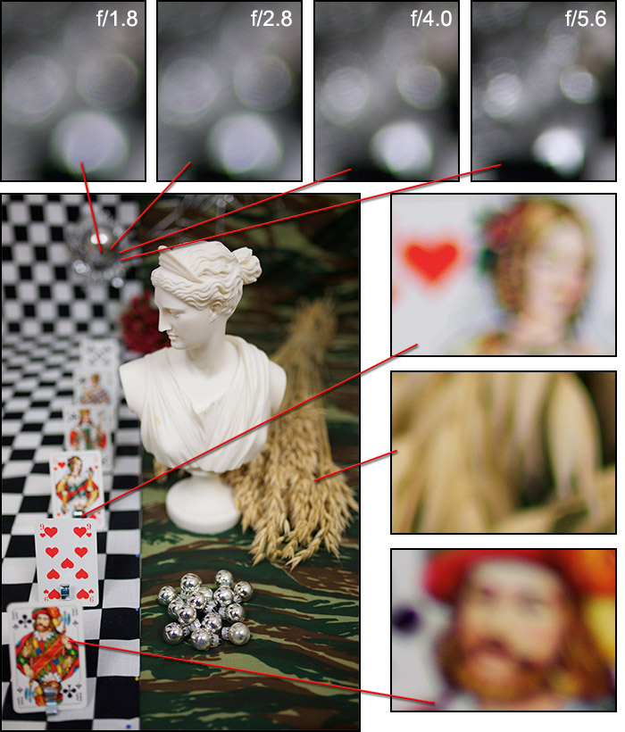

One of the primary usage scenarios for a large aperture lens is to isolate the main subject from the fore- & background via a shallow depth-of-field. The quality of the bokeh (out-of-focus blur) is of major significance for the overall impression of such images.
The Tamron SP 35mm f/1.8 Di VC USD provided mixed results within the scope of a moderate wide-angle lens. The general out-of-focus blur is quite smooth both in the foreground as well as in the more important image background, with some sings of nervousness in the latter.
Unfortunately out-of-focus highlights are pretty bad. As you can see below they suffer from a substantial amount "onion rings". This is usually caused by aspherical elements (the Tamron has 2 of them). There's no outlining effect and the circular disc shape remains intact at smaller apertures, but this doesn't rescue the situation here really.

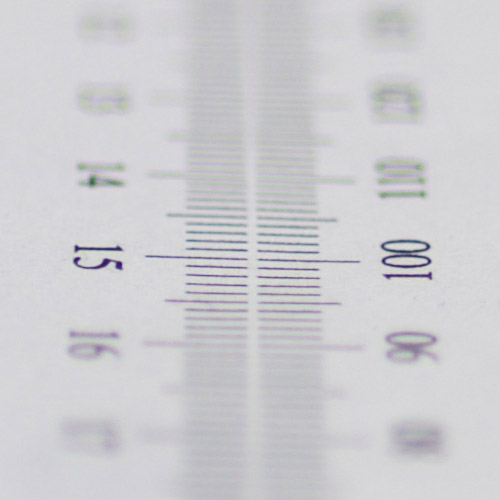

Bokeh Fringing
Bokeh fringing is a common issue with relatively fast glass. It's visible as halos of different colors in out-of-focus areas - magenta (red + blue) in front of the focus point and green beyond.
Typical for most fast primes, the Tamron shows noticeable bokeh fringing at large aperture settings, which can of course be reduced by stopping down.
In addition, these shots also illustrate that there is no visible focus shifting when stopping down.
Move the mouse cursor over the f-stop marks below to observe the respective bokeh fringing
