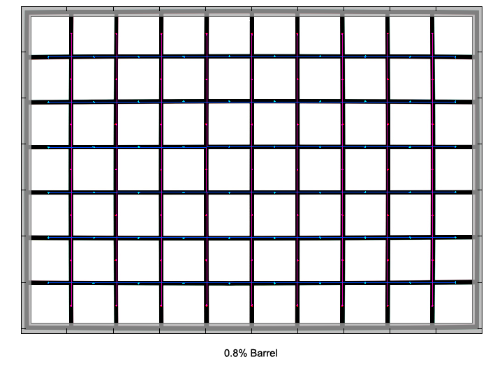

The lens shows a small amount of barrel distortion on DX cameras.

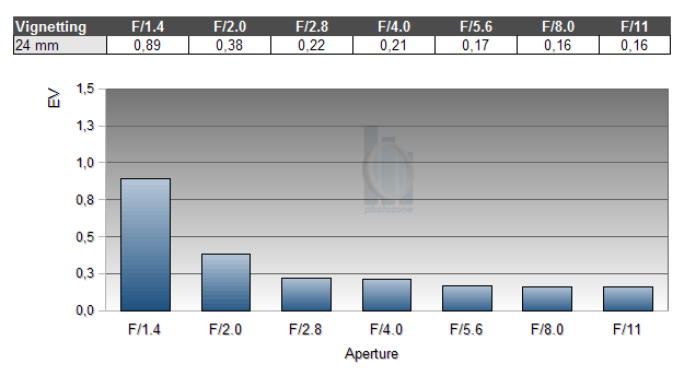

Being a FX lens, the Nikkor profits from the sweet spot advantage on DX cameras. So, even though it's a very fast lens, it shows only moderate vignetting wide open, which is reduced to an irrelevant level at f/2 already.

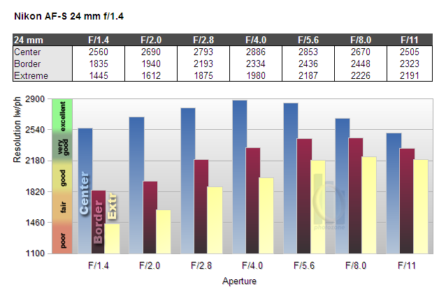

The lens delivers excellent resolution in the image center straight from the maximum aperture, down to f/8. From f/11 onwards, diffraction significantly reduces the resolution figures.
The borders show good resolution wide open. Stopped down to f/2.8 they reach very good levels. The extreme corners are rather soft wide open. The lens needs to be stopped down to f/5.6 to reach very good (albeit just) resolution here.

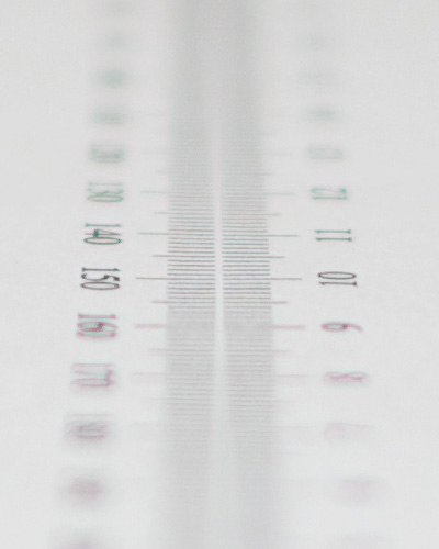

The lens showed some focus shift when stopping down (residual spherical aberration).

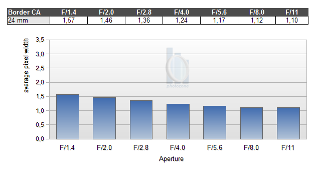

Chromatic aberrations (color shadows at harsh contrast transitions) are somewhat pronounced, reaching almost 1.6 pixels at the image border wide open. Stopping down reduces the amount a little, but even at f/11 more than 1 pixel of CAs remains.
However, CAs can easily be corrected in software or by the camera itself (most modern Nikon DSLRs remove CAs themselves if you shoot JPGs).

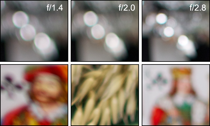

Bokeh Fringing
Bokeh fringing is a common issue with relatively fast glass. It's visible as halos of different colors in out-of-focus areas - magenta (red + blue) in front of the focus point and green beyond.
Typical for most fast primes, especially ultra fast ones, the AF-S 24 shows some amount of bokeh fringing at large aperture settings, which can of course be reduced by stopping down.
In addition, these shots also show the focus shift when stopping down, which was mentioned in the MTF section.
Move the mouse cursor over the f-stop marks below to observe the respective bokeh fringing
f/1.4 f/2.0 f/2.8 f/4.0 f/5.6

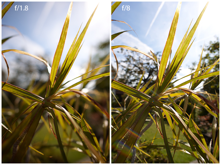

Flare/Glare
It does not come as a surprise that a lens as complex as the AF-S 24 produces some amount of flare in backlight conditions. As you can see in the f/8 sample below (shot with an FX camera), there's a single spot and a bunch of rainbow coloured shades opposite to the source of the light. However, thanks to Nano Coating the total amount is rather low and the contrast remains on a very high level. This (high contrast) is also true for large apertures, where the flare spot is larger but also more transparent and only single coloured and the rainbow flares are reduced to a slight haze.
These two images are also available in full resolution in the sample images section of the FX review of this lens.
