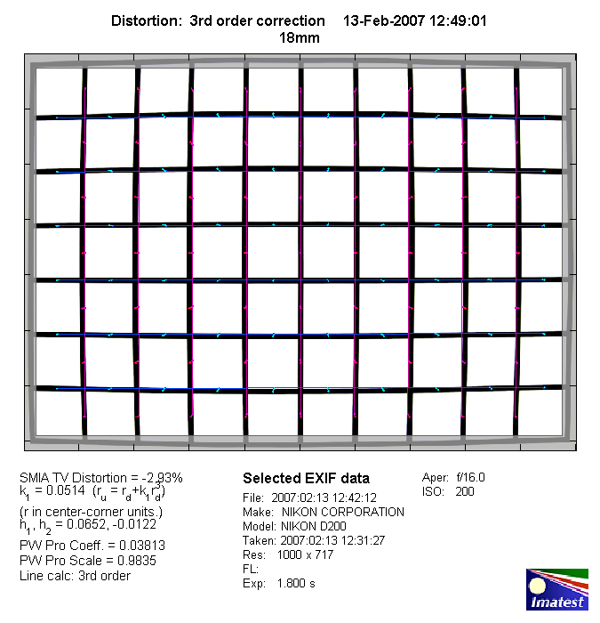

The 18-50mm EX shows the quite typical distortion characteristic for a lens in this class. At 18mm there is very pronounced barrel distortion which eases continuously towards the long end of the zoom range. At 35mm and 50mm the lens is basically free of distortion.
18mm 24mm 35mm 50mm

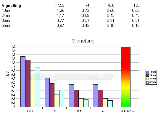

As mentioned the 18-50mm EX is a reduced image circle lens (APS-C) and typical for such lenses the vignetting is more pronounced compared to classic full frame lenses. Unsurprisingly the problem is most significant at f/2.8 at all focal lengths with a peak of 1.26EV at 18mm f/2.8. Generally it is a good idea to stop down to f/4 in situations where a high degree of vignetting could be disturbing.

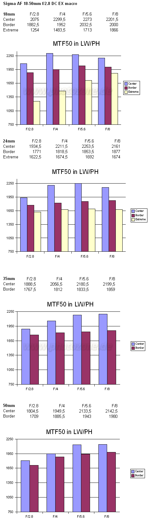

The Sigma AF 18-50mm f/2.8 EX DC macro exhibited a rather mixed performance in the MTF lab. The center performance is very good to excellent at all focal lengths. The weak spot of the lens is at 18mm where the extreme borders are soft at f/4 and more so at f/2.8. At medium apertures the lens is very sharp across the frame. At 24mm the extreme borders are better at large aperture settings but don´t really improve significantly when stopping down. At 35mm and 50mm the border resolution is generally very good.
The tested sample suffered a bit from a centering problem which probably affected the performance at large aperture settings to some degree.

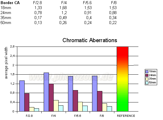

Chromatic aberrations (color shadows at harsh contrast transitions) can be a problem at 18mm. The average CA pixel width at the image borders easily exceeds 1px with a peak at 18mm f/4 (~1.7px). This will be visible in some situations unless you correct the issue via an imaging application. The situation eases towards the long end of the zoom range and at 35mm and 50mm lateral CAs are very low even by critical standards.
