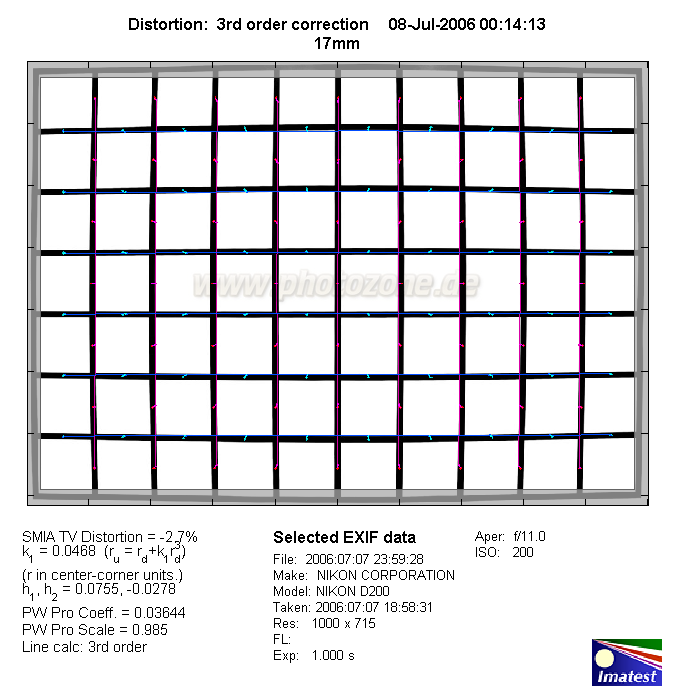

The AF 17-50mm f/2.8 SP XR exhibited average distortion figures for a lens in this class. As expected there is pronounced barrel distortion (2.7%) at 17mm which evens out around the 24mm setting. Beyond the images show a moderate degree of pincushion distortion (0.9% @ 50mm).
17mm 24mm 35mm 50mm

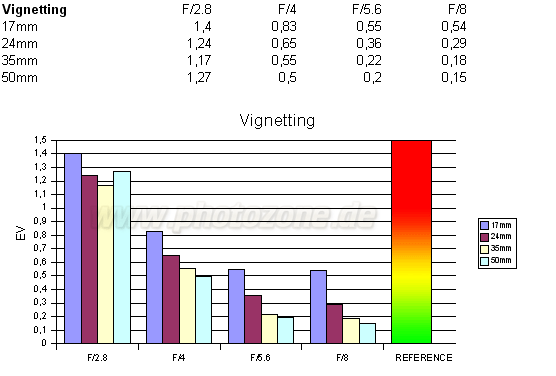

The AF 17-50mm f/2.8 SP XR is a reduced image circle lens and these lenses tend to produce higher vignetting figures. At f/2.8 the lens shows pronounced vignetting of 1.4EV at 17mm, 1.27EV at 50mm and a slightly less in between. Stopping down helps to reduce the problem.

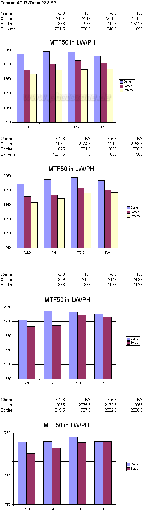

Many dedicated APS-C lenses suffer from performance problems towards the corners of the image field but, surprisingly, the Tamron AF 17-50mm f/2.8 SP XR is one of the few lenses that which are capable to break this trend.
At 17mm and 24mm the lens was even able to reach some of the highest measured LW/PH values ever tested in the center of the image (@ f/4-5.6). Even wide open the quality is already very good. At 24mm the quality remains basically on the same high level. At 35mm and 50mm there's a really marginal decrease in center performance whereas the border quality remains exceptionally high (for such a lens).

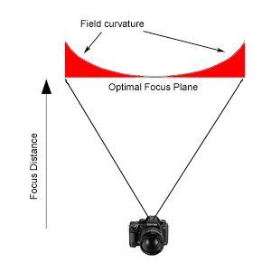

The lens showed a moderate degree of field curvature.
