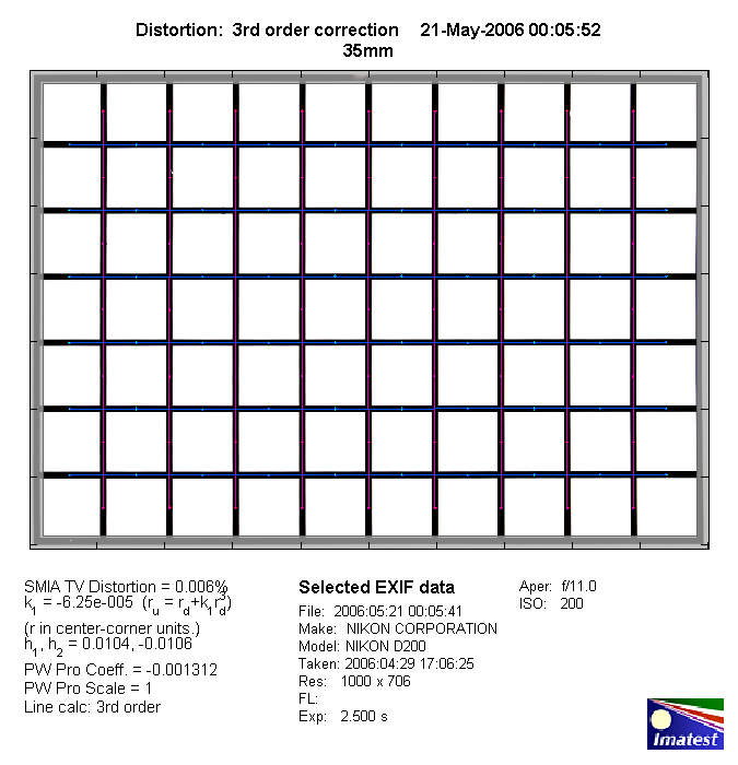

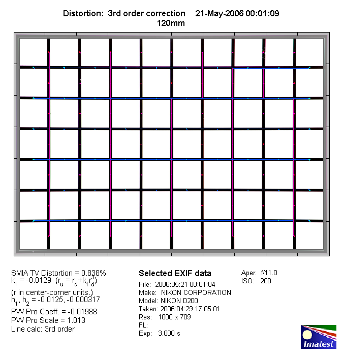

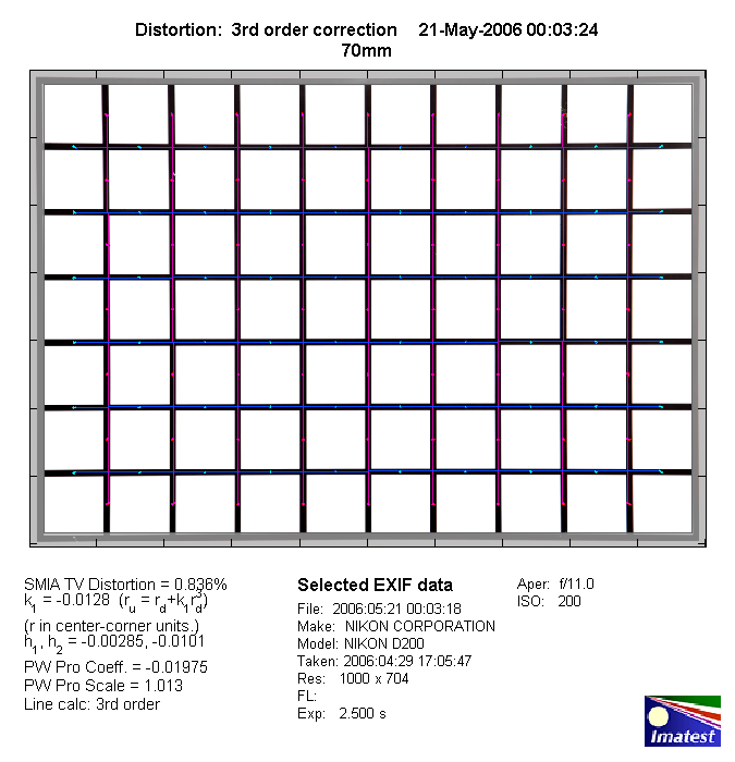

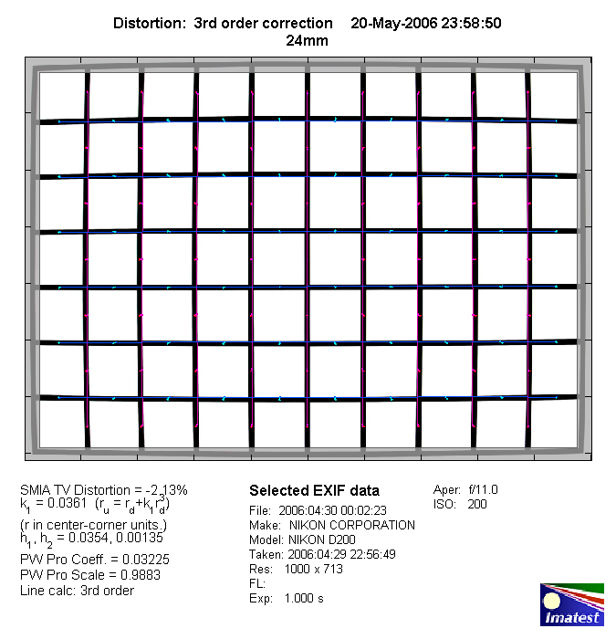

The AF 24-120mm has a rather aggressive 5x zoom ratio so distortion is a little higher than average. Typical for such zooms there is some pronounced barrel distortion at 24mm (2.1%) changing to moderate pincushion distortion (0.8%) towards the long end of the zoom range. At 35mm the lens is free of distortion.
24mm:
35mm:
70mm:
120mm:

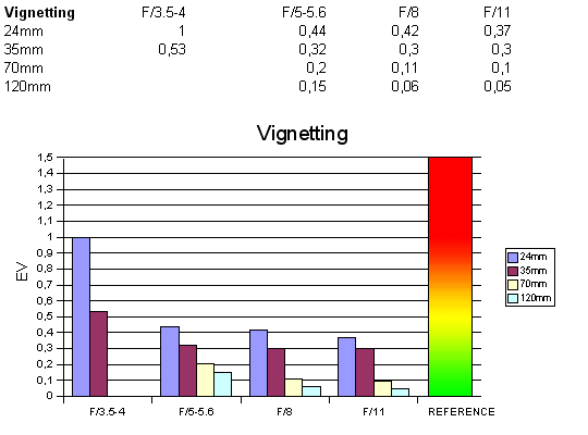

The AF 24-120mm VR is a full frame lens so on an APS-C DSLR it can take advantage of a sweet spot effect and generally the issue is quite well controlled. As to be expect the vignetting is most pronounced at 24mm @ f/3.5. At around 1EV vignetting may be visible at times here but the problem doesn't reach extreme degrees and if needed stopping down helps to reduce the issue significantly. At the other tested focal lengths the issue isn't really field relevant.

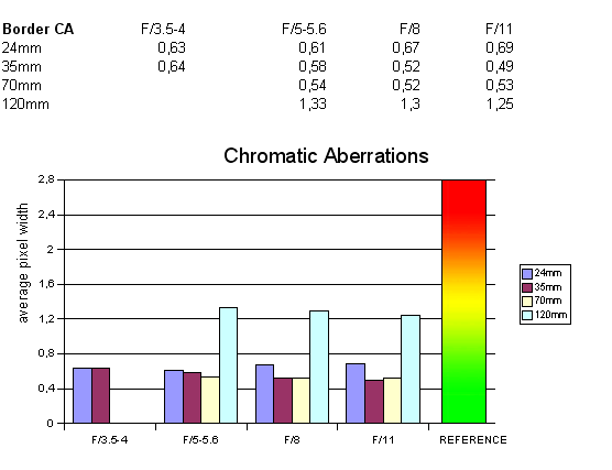

Chromatic aberrations (color shadows at harsh contrast transitions) are very low between 24-70mm. CAs increase somewhat at 120mm with an average CA width beyond 1px at the image borders.
