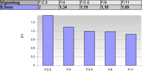

The amount of vigneting isn't quite as impressive unfortunately. At f/2.8 we measured a light falloff of 2EV (f-stops) which is beyond our usual scale for MFT actually. Stopping down eases the problem but the issue never goes below 1EV. This can be visible in some scenes.

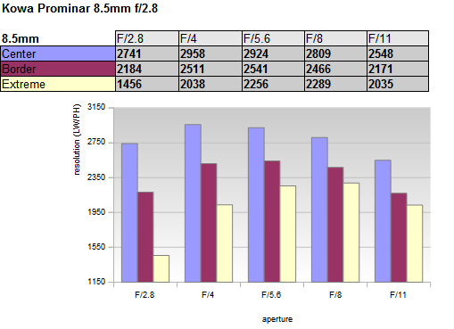

The Kowa Prominar MFT 8.5mm f/2.8 can deliver decent resolution figures but it's not perfect. At fully open aperture, the center is already sharp and the borders are also pretty good. However, the extreme corners are soft. Stopping down to f/4 boosts the quality across the image field with an outstanding center followed by a very good border and good corners. The peak performance is reached between f/5.6 and f/8. Diffraction has a higher impact from f/11 onward but then you rarely need such settings on Micro-Four-Thirds cameras.
The tested sample had a good centering quality.

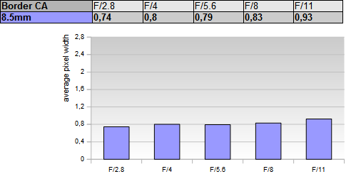

Lateral CAs (color shadows at harsh contrast transitions) are just slightly visible with an average pixel width of around 1px at the image borders. This is not disturbing though.
