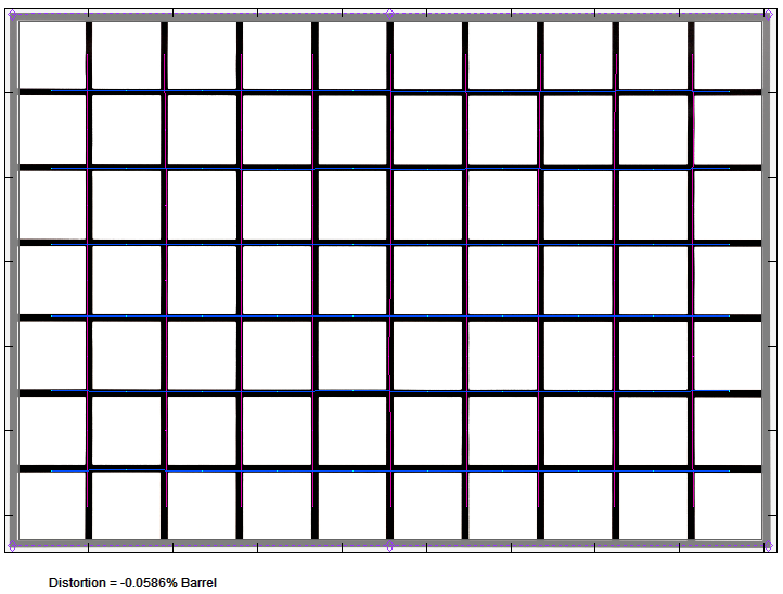

The Fujinon XF 35mm f/2 R WR has two souls in terms of distortions. Fujifilm uses an auto-correction system thus you won't really notice any distortions unless you switch it off (e.g. in CaptureOne).
The original distortion characteristic is worse than that though. A barrel distortion of 4.1% is heavy for a prime lens.

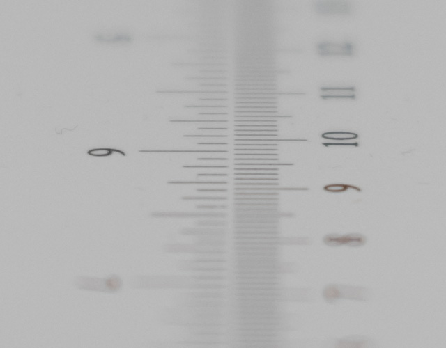

The Fujinon XF 35mm f/2 R WR delivers a good albeit not outstanding performance. The center quality is already excellent at f/2 and the outer image region reaches good figures here. The quality increases the further you stop down with a peak at f/5.6. The final kick in crispness is missing in the extreme corners but the borders are impressive. Diffraction reduces the quality from here on but the results are still very good at f/11.
The centering quality of tested sample was Okay (slight softening on the far right side).

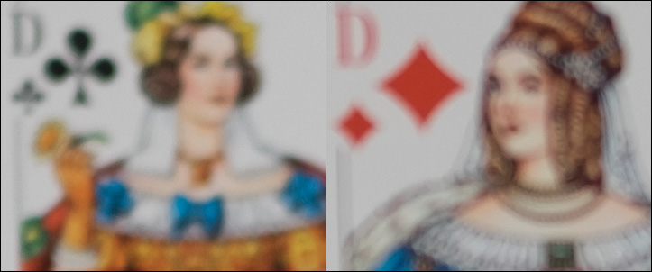

Bokeh Fringing
Bokeh fringing is an axial color fringing effect. It can show up as purple halos in front of the focus point and greenish halos in the background. Like most of large aperture lenses the Fujinon is also affected with some visible fringing at f/2. Stopping down reduces the issue but traces remain even at f/4.
f/2 f/2.8 f/4
