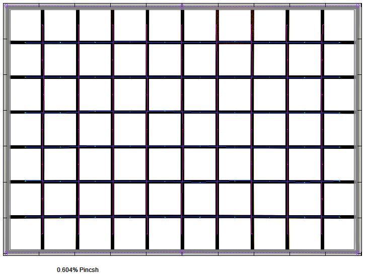

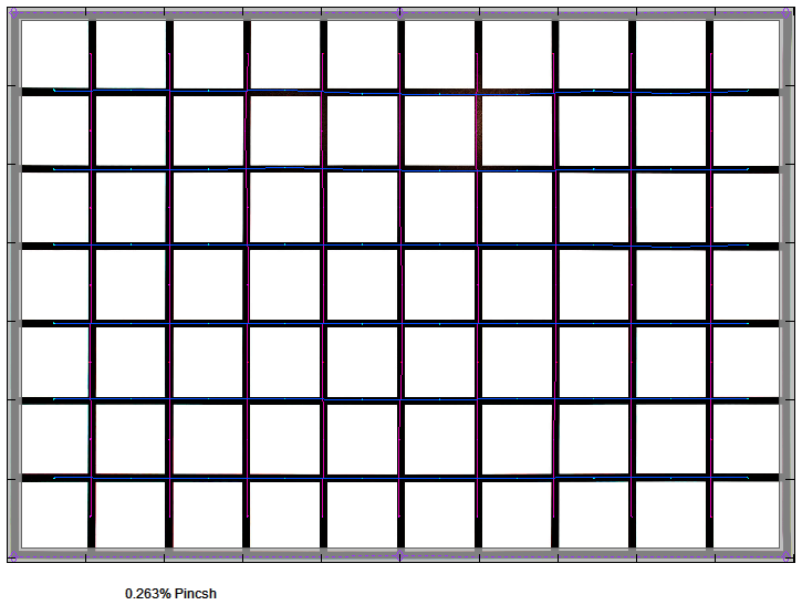

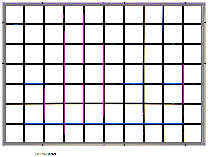

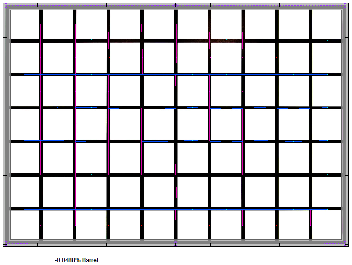

As far as image distortions are concerned, there are two sides of the truth. By default the camera and most software is correcting this flaw so most users will actually not notice any issues in this chapter. That being said it remains a choice whether auto-correction is activated. If you chose not to do so, you will notice a very heavy degree of barrel distortion (4.9%) at 10mm. However, at 14mm and 18mm, distortions are minimal before changing to a medium degree of pincushion distortion at 24mm.
If you move your mouse cursor over the image you can switch to the corresponding non-corrected results.

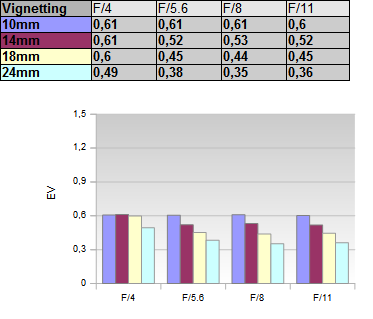

Vignetting is another aspect which is usually auto-corrected and as such only noticeable by the somewhat higher degree of sensor noise in the image corners.
Vignetting in JPEG mode:

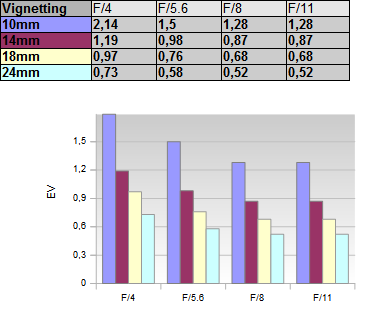

In RAW mode - thus with disabled distortion and vignetting compensation - it is a different story altogether. At max. aperture there's an extreme light falloff at 10mm f/4 and it remains fairly heavy even when stopping down (although to be fair - this is also caused by the "natural" vignetting). The issue isn't quite as pronounced at the other settings but it's generally a good idea to stop down to f/8 when sticking to the "pure" image.
Vignetting in "RAW" mode:

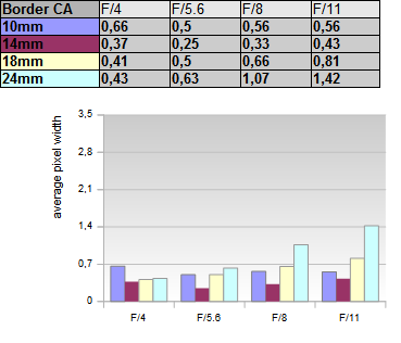

Lateral CA (color shadows at the image borders) are well controlled for an ultra-wide zoom lens. In the 10mm to 18mm range, they remain easily below an average pixel width of 1px at the image borders. They increase beyond that at 24mm when stopping down to f/8 and beyond - although even so the issue remains moderate.
