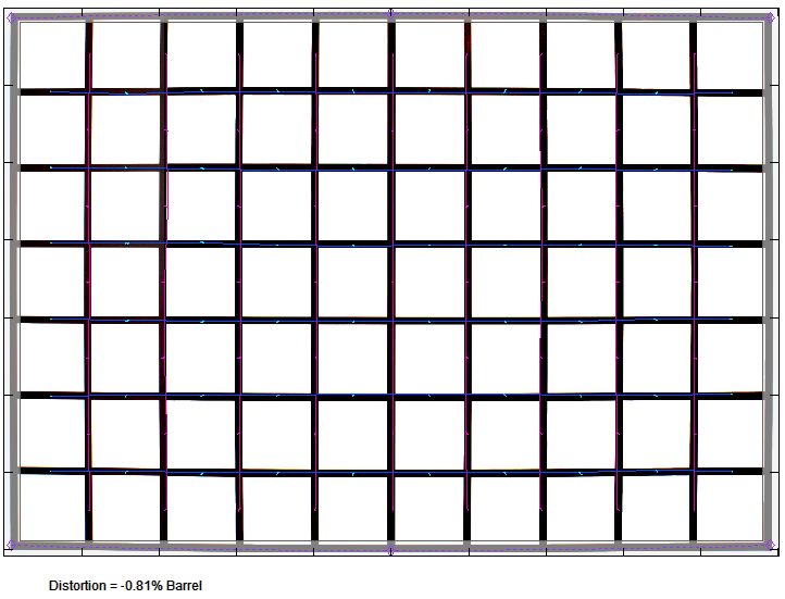

You may notice the "Zero-D" or zero distortion in the name of the Laowa lens. While you can spot a barrel distortion upon close observation, it is marginal really. It is especially worth mentioning that this was achieved without any digital auto-correction.
Note: Imatest is sometimes exaggerating the numeric distortion figures. Looking at the image we are probably talking about image distortions below 0.5% rather than the 0.8% that Imatest calculated there.

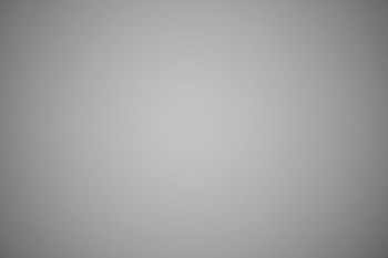

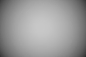

The Laowa 9mm f/2.8 Zero-D has one weakness - vignetting. It exceeds 4(!) EV/f-stops at f/2.8 and stopping down to f/8 reduces it to 2 EV.
While this may sound terrible - and it is certainly no good at f/2.8 (to the left below) - it isn't quite so relevant at medium apertures in real life. At f/8 (to the right below) the light falloff isn't fully exponential but relatively linear.

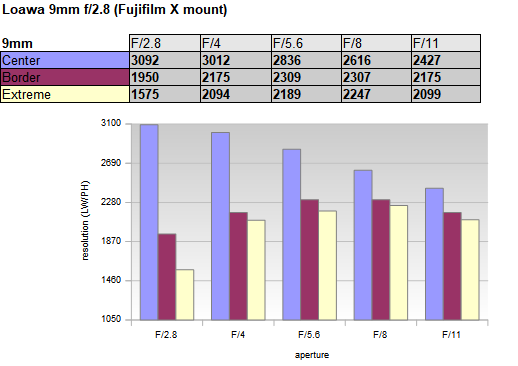

The resolution characteristic of the Laowa 9mm f/2.8 Zero-D is decent. The center performance is actually outstanding at f/2.8 and decreases from there due to (normal) diffraction effects. The outer image field isn't quite on that level, of course. At f/2.8 the borders are still good but the corners are soft. Stopping down to f/4 boosts the corners to good levels already. The sweet spot is reached between f/5.6 and f/8 where the borders/corners are scratching the very good mark.
The centering quality of tested sample was good (we tested a prototype).

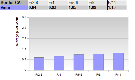

The lateral CAs (color shadows at hard contrast transitions) are low with an average pixel width around 1px at the image borders. This is usually not disturbing.
