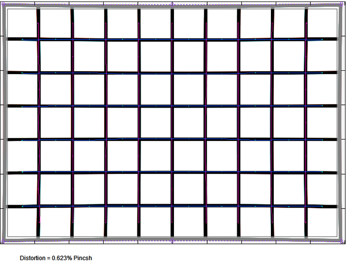

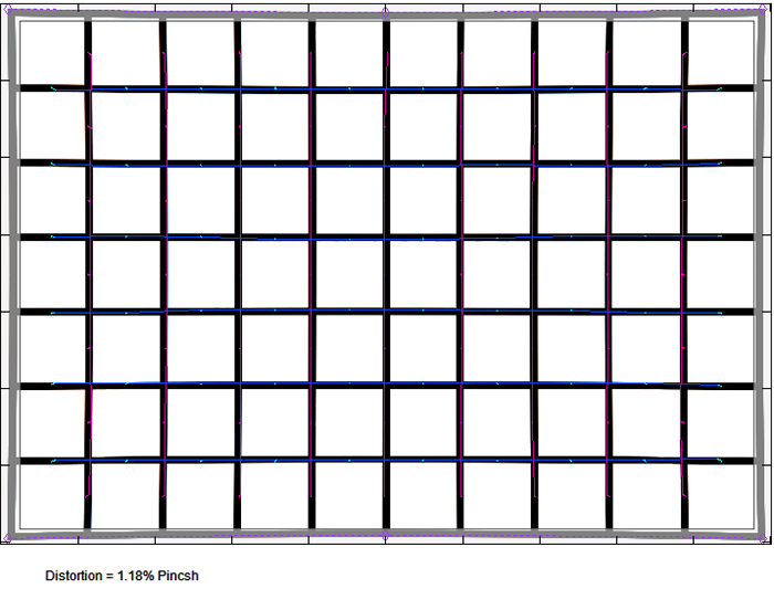

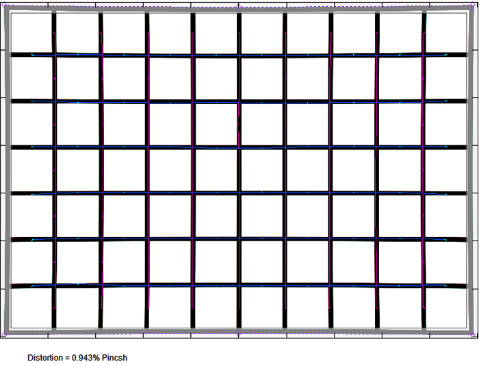

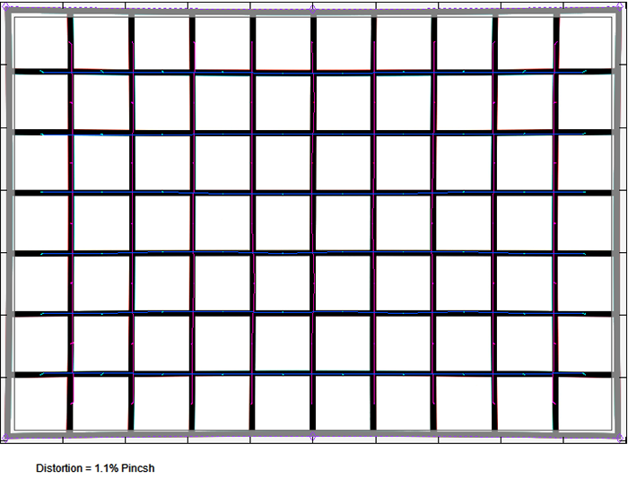

The Tamron lens produces pincushion distortions throughout the zoom range with a peak of 1.2% at 300mm and a minimum of 0.6% at 450mm. This isn't overly relevant when it comes to nature scenes but it can be noticeable with architecture photography.

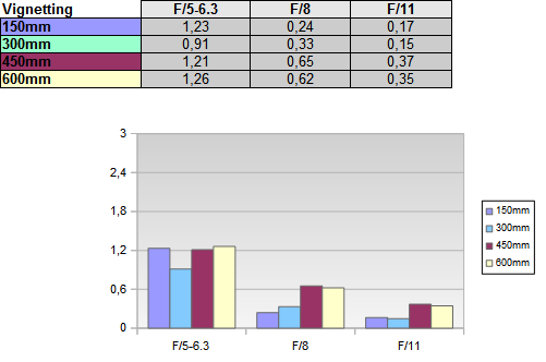

There's a moderate degree of vignetting at maximum aperture throughout the range with a peak of about 1.2EV (f-stops). While this is visible for sure, it is not extreme by full format standards. Stopping down to f/8 resolves most of the issue and it's negligible beyond.

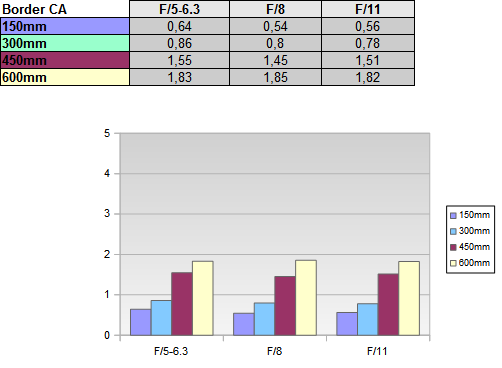

Lateral chromatic aberrations (color shadows at the image borders) are very well controlled between 150mm and 300mm. Beyond they increase to moderate levels and can get visible in critical scenes.

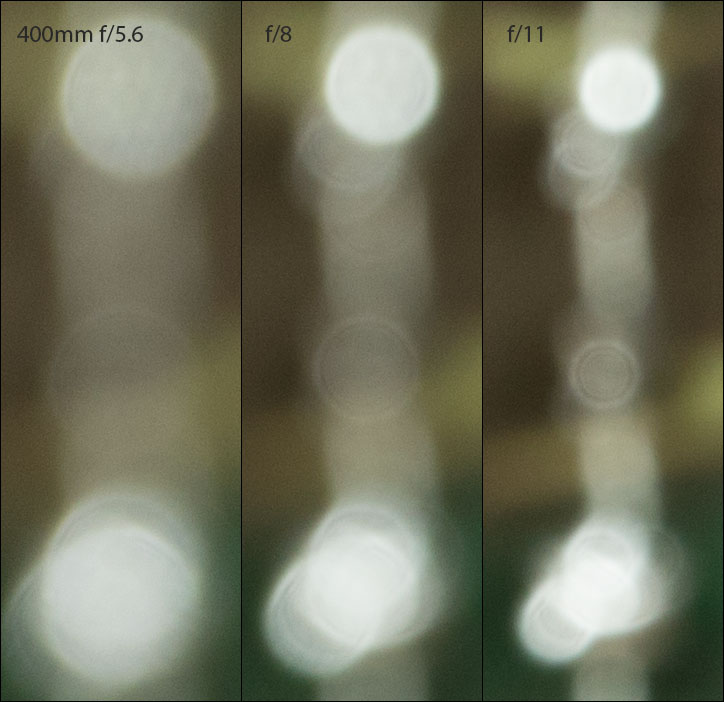

Out-of-focus highlights are pleasing of they are sufficiently "big" but once they compress they show an onion-like substructure that is getting pronounced the more you stop down. As usual you'll also have to live with "cat's eyes" at the image borders.

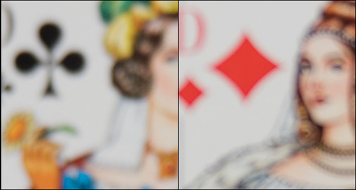

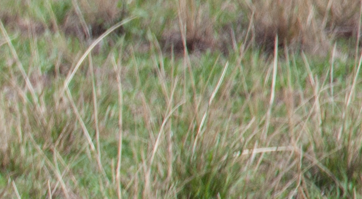

As far as the general out-of-focus blur is concerned - the background is quite smooth (left hand sample crop below) whereas the less critical foreground blur (to the right) is somewhat more harsh.
That being said you can always push a lens into a situation where it looks bad with respect to its bokeh. Below is a sample crop which shows an out-of-focus image portion with extreme contrasts. Few lenses can compensate such a situation and neither can the Tamron. However, if the contrast spread remains moderate the results are pretty good.
