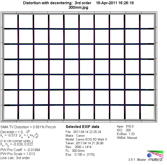

The EF 300mm f/4 USM L IS produces only a slight amount of pincushion distortion (~0.85%). This shouldn't be a problem in field-conditions.
The light falloff is very well controlled at just ~0.6EV (f-stops) at f/4 - this is rarely visible in very critical scenes. Stopping down to f/5.6 reduces the vignetting to a negligible degree.

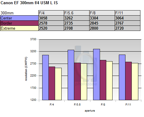

The resolution characteristic of the Canon EF 300mm f/4 USM L IS is undoubtedly decent but it stays a little short of the high expectations. The center quality is already very good at f/4 but the borders/corners at softer with only good results. Stopping down lifts the center resolution just beyond the excellent barrier and the borders/corners to very good levels. This sounds good but the recently tested EF 70-300mm f/4-5.6 USM L IS isn't any worse actually. Diffraction effects reduce the quality from f/11 onwards.

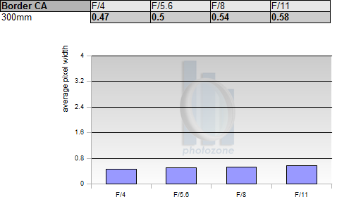

The CAs (color shadows at harsh contrast transitions) are well below disturbing limits with an average pixel width of less than 0.6px at the image borders.

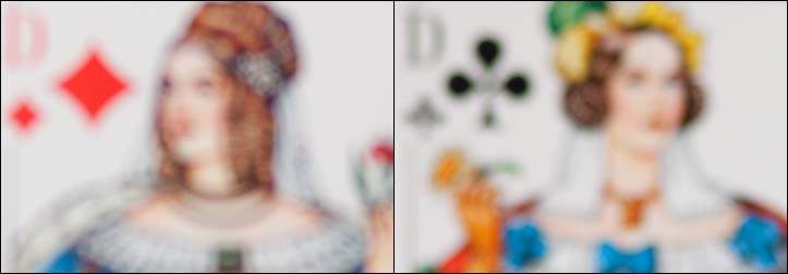

The EF 300mm f/4 USM L IS is, at least technically, not a large aperture lens. Nevertheless you can achieve a small depth-of-field using such a long focal length in conjunction with a close object distance.

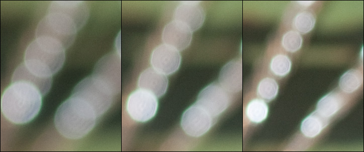

The quality of the bokeh is decent but not without flaws. Out-of-focus highlights are circular at f/4 but the inner highlight zone has a rather nervous rendition. The non-circular aperture blades get also obvious when closing the aperture.
The quality of the out-of-focus blur is slight nervous in the foreground (see the sample crop to the left below) but smooth in the (more critical) background.
LoCAs (non-coinciding focal planes of the various colors), sometimes called "bokeh CAs", are visible at f/4. Stopping down to reduces the effect but you can still spot some slightly greenish (foreground) to purple (background) halos at f/8.
f/4 f/5.6 f/8
