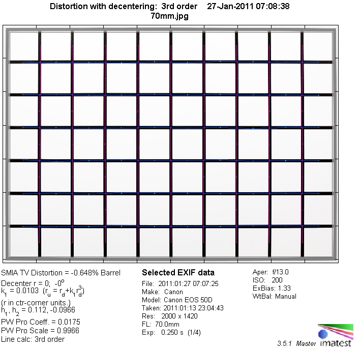

The Tamron SP lens produces a slight amount of barrel distortion at 70mm and slight pincushion distortion in the middle to upper zoom range. You may notice that the tested sample reported "188mm" at its 200mm setting. It is not clear whether this is typical for the design or a zoom limiter which set in too early on this copy/instance of the lens.

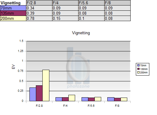

The Tamron 70-200mm SP is a full format lens which enjoys a sweet spot advantage when used on APS-C DSLRs. Consequently there's only a marginal amount of light falloff at 70mm and 135mm. In very critical scenes you may spot some vignetting at 200mm at f/2.8 but it's really a non-issue otherwise.

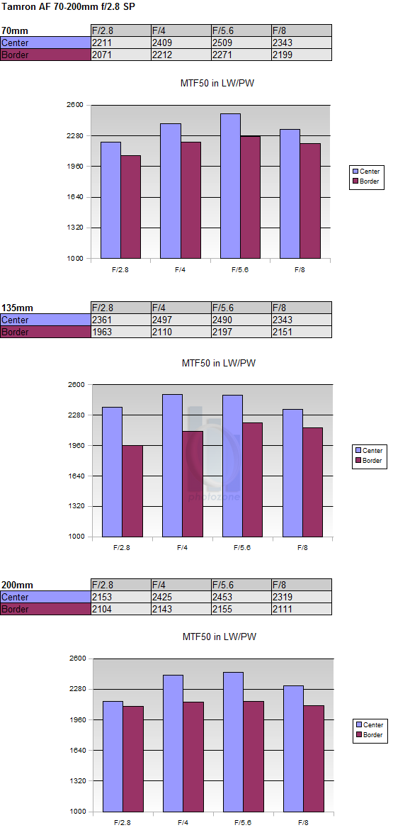

The Tamron lens produced quite impressive MTF figures in our lab. The results are pretty uniform across the range with a generally excellent center performance and very good borders. There's just a little drop in center quality at 200mm @ f/2.8 which originated primarily in a very slight centering defect at this setting.

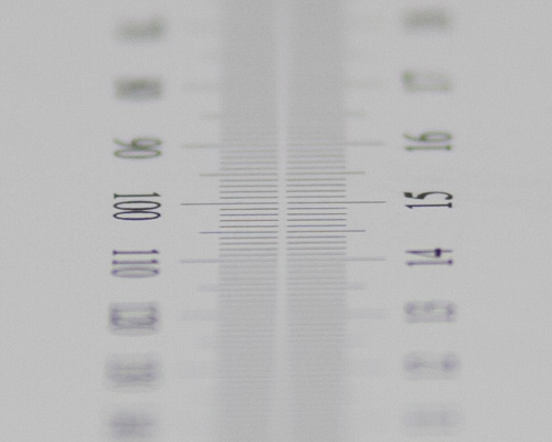

The amount of field curvature is marginal. While not formally tested it was quite obvious that the performance decreases towards very close focus distances at the long end of the zoom range.

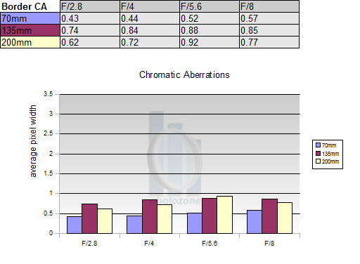

Chromatic Aberrations
Lateral CAs are generally very well controlled with an average CA width of less than 1px at the image borders. This is usually nothing to worry about in field conditions.

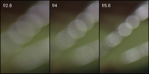

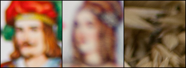

Fast tele zoom lenses should be able to provide a pleasing bokeh (out-of-focus blur) for typical shallow depth-of-field applications such as portraits. The Tamron lens does not disappoint here. Out-of-focus highlights are nicely rendered with a circular shape at the relevant aperture settings and a smooth inner disc zone. The background and foreground blur is very smooth whereas the critical focus transition zones is a little more nervous. All-in-all a very good characteristic here.
These sample portions were taken at ~140mm.
Bokeh fringing is a color fringing effect in the focus transition zone showing a purple halo in front of the focus zone and a green one beyond. The Tamron lens has a rather typical characteristic here with a medium degree of LoCAs at f/2.8. The effect is mostly gone at f/4 and basically negligible at f/5.6. The aspect is more pronounced at 200mm - the sample crops below were taken at 135mm.
Note: the full format test results have been reused here. The samples were taken from the image center so the findings remain valid here of course.
f/2.8 f/4 f/5.6
