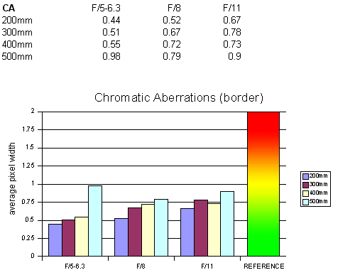

CAs (color shadows at harsh contrast transitions) are generally very low in the 200-400mm range. At 500mm f/6.3 the problem increases significantly to a maximum of 1 pixel on the average at the image borders - no disaster but visible at times.
