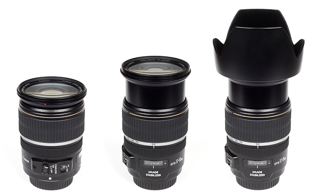

As mentioned the lens is not a designated L grade lens and while this may not be really obvious based on the naked specifications it does show up with respect to its build quality. This doesn't mean that it isn't decent but the outer construction is only made of good quality polycarbonate (except for the metal mount) whereas the recent L grade zooms are magnesium-alloy constructions. Nonetheless the lens feels quite solid (similar to the EF-S 10-22mm USM) and the zoom and focus control rings operate reasonably smooth although not damped. As you can see in the product shot below the lens extends when zooming towards the long end of the zoom range. Thanks to an internal focusing system the front element does not rotate so using a polarizer remains easily possible. The EF-S 17-55mm IS has no sealing against dust or humidity - and there were already user complaints about dust sucking tendency of the lens over time. Unfortunately Canon decided NOT to include a lens hood which is a little bizarre regarding the pricing of the lens.
